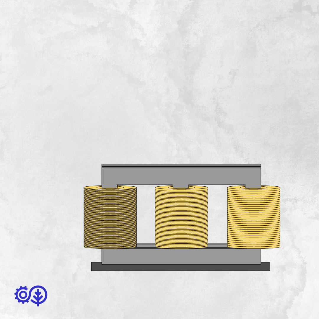

Separate coils—made of copper or, increasingly, aluminum—are wound around the columns of the core. The core-coil unit will do the “transforming” that gives this machine its name.
As electrical current flows through the first coil, it induces a magnetic flux through the steel core, which in turn induces current in the second winding. The voltage that the second winding conducts is determined by the ratio between the number of coils in the first and second windings. Because voltages can fluctuate, transformers are installed with devices (called tap changers) that can adjust the number of windings of coils while the transformer is in operation.
Much like the laminated steel core—and for the same reasons of electromagnetic efficiency—coils in large power transformers do not consist of single pieces of solid metal, but an intricately entwined cable of individually insulated copper strands. Each strand, as one manufacturer explains, “consecutively and repeatedly assumes every possible position inside the cable.”

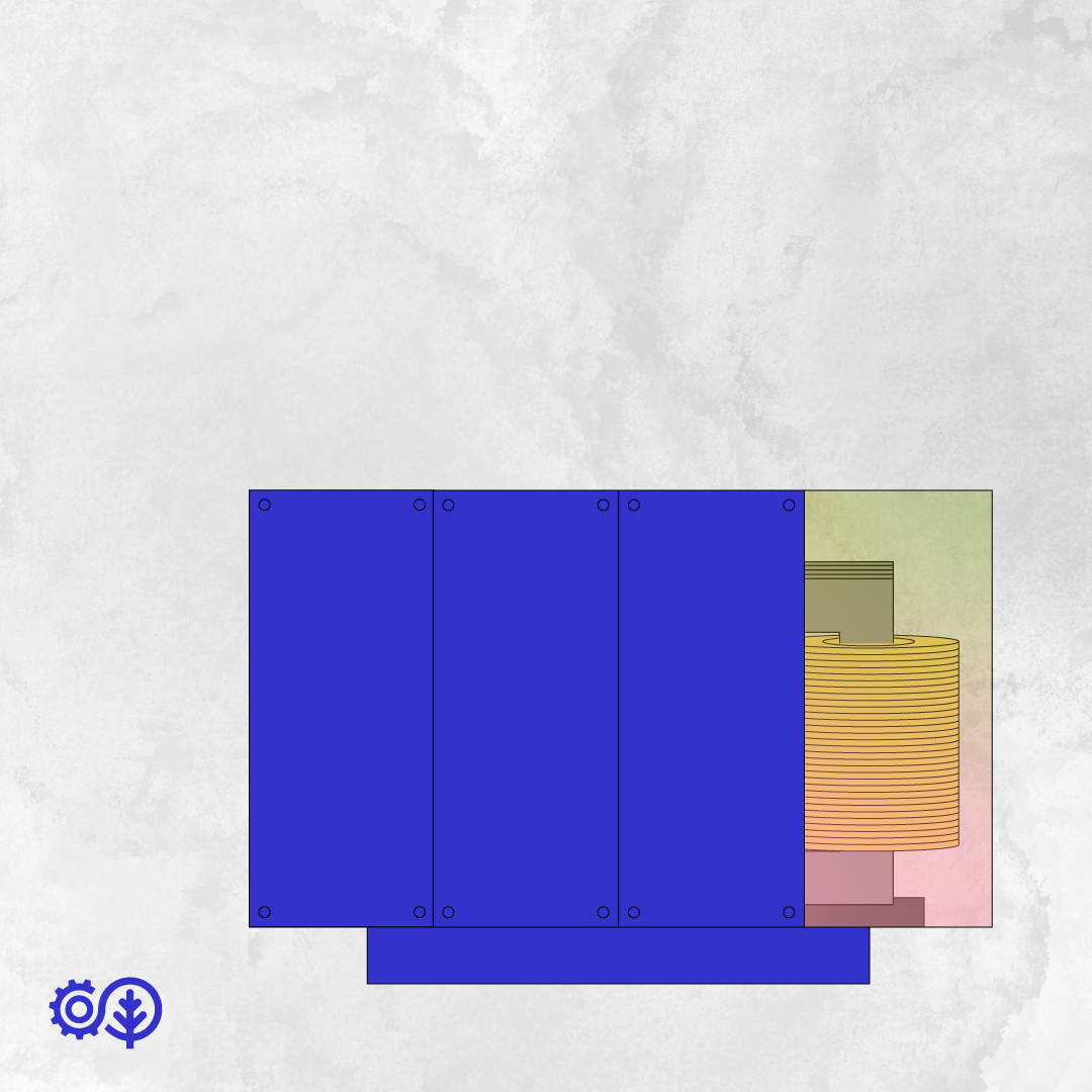

Once the core-coil unit has been assembled, it is thoroughly cleaned and extra insulation, made of paper, is added to the unit. The whole thing is then baked in a vacuum-pressure oven, which dries out the unit at a low temperature.
To avoid absorbing moisture from the air, the unit is then promptly lowered into a steel tank, and the tank is filled with insulating oil.

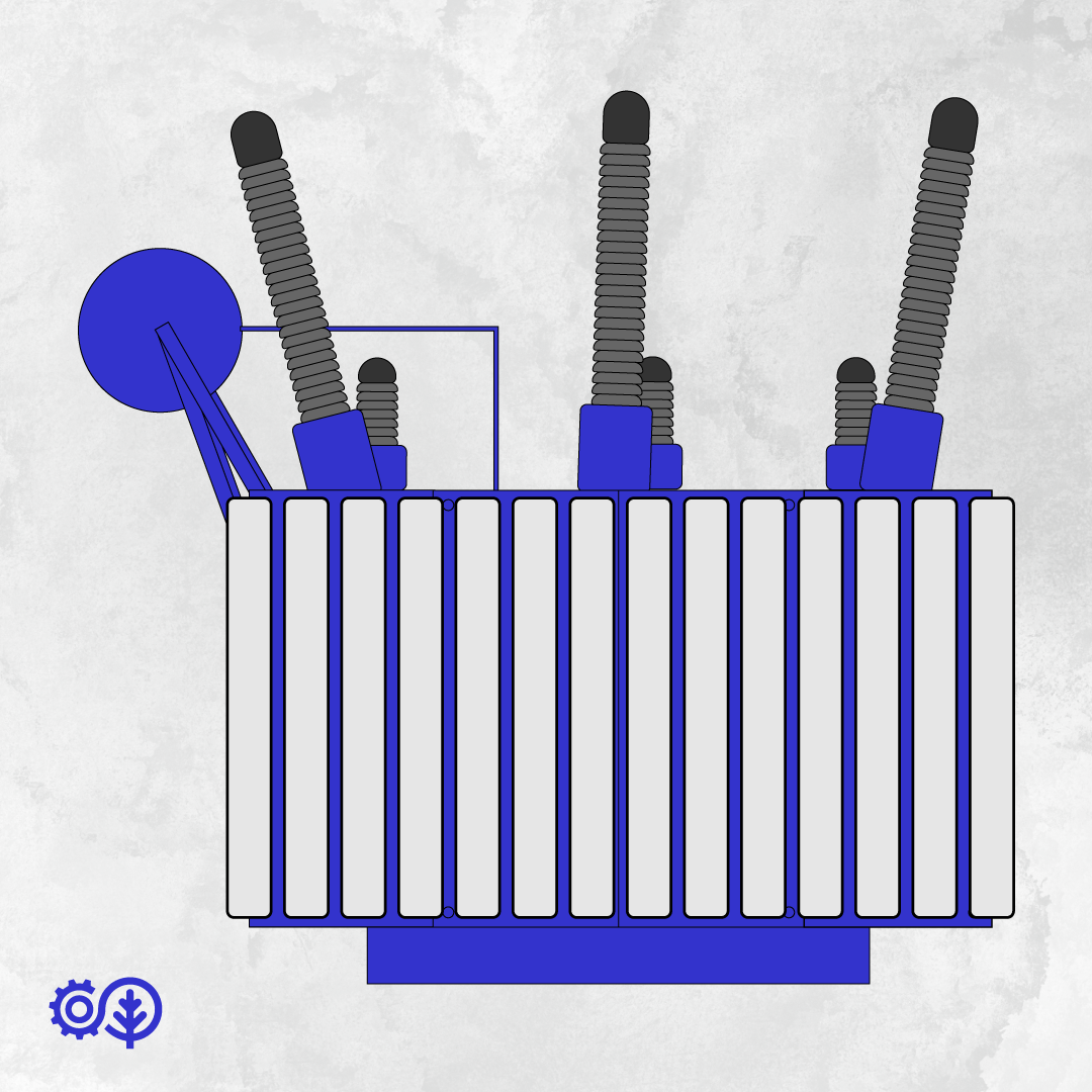

The tank is also fitted with drain valves, explosion vents, and bushings. These oddly shaped, antennae-like things will connect the transformer to the electrical lines of the grid.

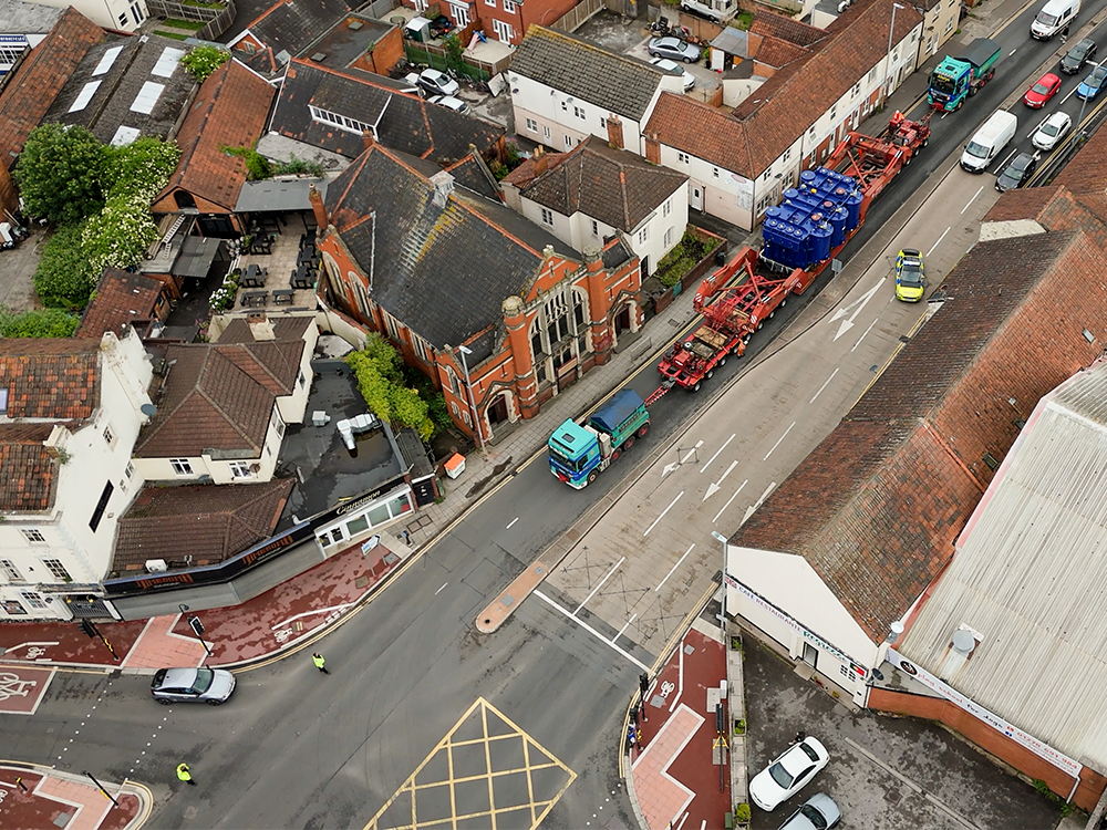

Once the transformer is deemed grid-worthy A super grid transformer travelling with police escort through the British town of Bridgwater. Despite being under 9 meters long, it weighs 174 tonnes—equivalent to 30 African elephants. Source: National Grid
Once the transformer is deemed grid-worthy, it then has to be transported—no mean feat considering that large power transformers weigh hundreds of tonnes. “A lot of work goes into transformer deliveries, long before any electrons pass through them,” said Roisin Quinn, director of asset operations at the UK’s National Grid, in a press release about 2024 transformer deliveries. “Multiple teams across National Grid and its supply chain are involved in moving and installing these huge devices.”
